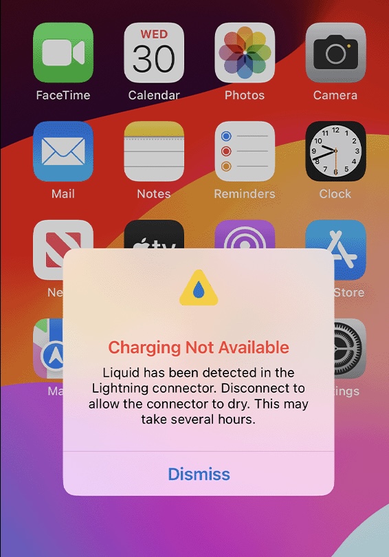

Hi bro this is Praveen im using iphone 15 pro, after updating to ios 18.1 after 3days of update i got liquid detected please remove your charging cable warning , so after 24hrs under fan dry i got same warning for more than 3 to 4 days ,so i have taken my phone to ritchi street shops i have discussed with 4 to 5 shope they advised me to replace charging port for 3500Rs and i have seen another person also there for same reason and he changed the charging port even after changing he got the same issue while connecting for first 2times and then its fixed I don’t have believes on them so i have taken my iphone to apple authorised service centre they said me that many people come there for same issue after 18.1 update and they said me that it is software issue and they advice me to use wireless charger for charging they said me that it fixes temporary if we charge with wireless for 30% after if we use charging cable it will work fine for some people ,they said this issue will be fixed in next update
Im telling this because in some shops they are taking this as their advantage and getting money from customers and changing the orginal port so i felt everyone should have awareness about this and everyone should go it authorised service center once before changing or replacing any iphone component to know the exact reason so I request you to kindly post a video on your channel regarding this
hello praveen, if there is a liquid or dusts problem we may see such warning.
iOS 18.1 is not the issue here, as not many users are experiencing the same problem. this liquid warning message did reported even in iOS 16 or 17 and when liquid contact is not the reason, dusts clogged inside charging port also another possible reason.
Once device serviced outside apple service center we cannot change battery or other service at apple service center in future.
Expecting iOS 18.2 by 2nd week of december bro. If the issue is not resolved by then, consider checking with apple service center once.
You have the correct suggestion at the end of your question and sure I will check with some more contacts of mine and see if anyone else experiencing similar problem bro.
Also during this rainy season, make sure to avoid any possible water contact to the charging port or to the charging cable. that will help too.
No bro there is no dust or liquid in my port even though my port is cleaned in apple authorised service center as I requested them to clean my port ,even after cleaning im getting the same issue and i got new apple 240w 2m charging cable on the same day when I cleaned my port, may be your contact people are not facing this issue but my neighbour also had this same problem yesterday he went to 2authorised service centre and they cleaned the port still he is facing the same issue and they said its software bug, ok thank you anyway if your contact people got such issues please post awareness video regarding this thanks for your reply bro
So far no similar issue reported bro. If the issue is specific to your device, then we can try with iOS Restore after taking backup of data.
If its manageable you can wait till iOS 18.2 drops 2nd week of december.
that could help fixing it if its software issue bro.
Hey bro… I’m having the exact same issue. I’ve let my port dry out and even cleaned it but I’ve been getting said error message since I updated my iOS version
hi bro, sometime dusts related reasons could cause similar issue too. If the issue is not solved after next weeks iOS 18.2 update kindly visit nearest apple service center bro. need to be checked whether any hardware issues there or not.
