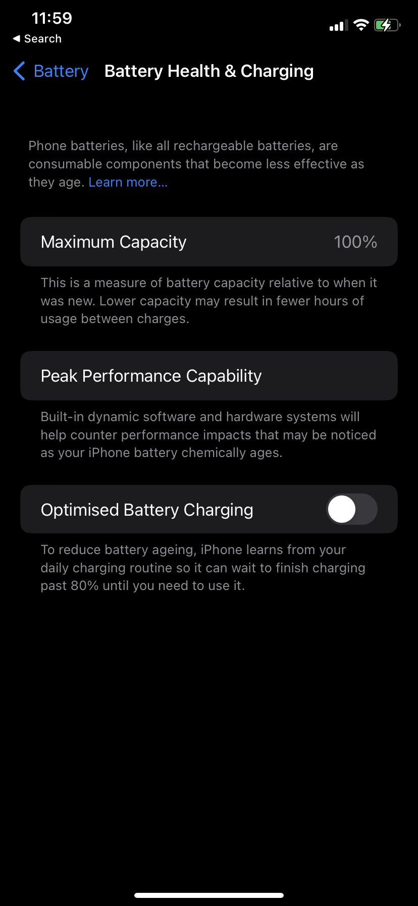

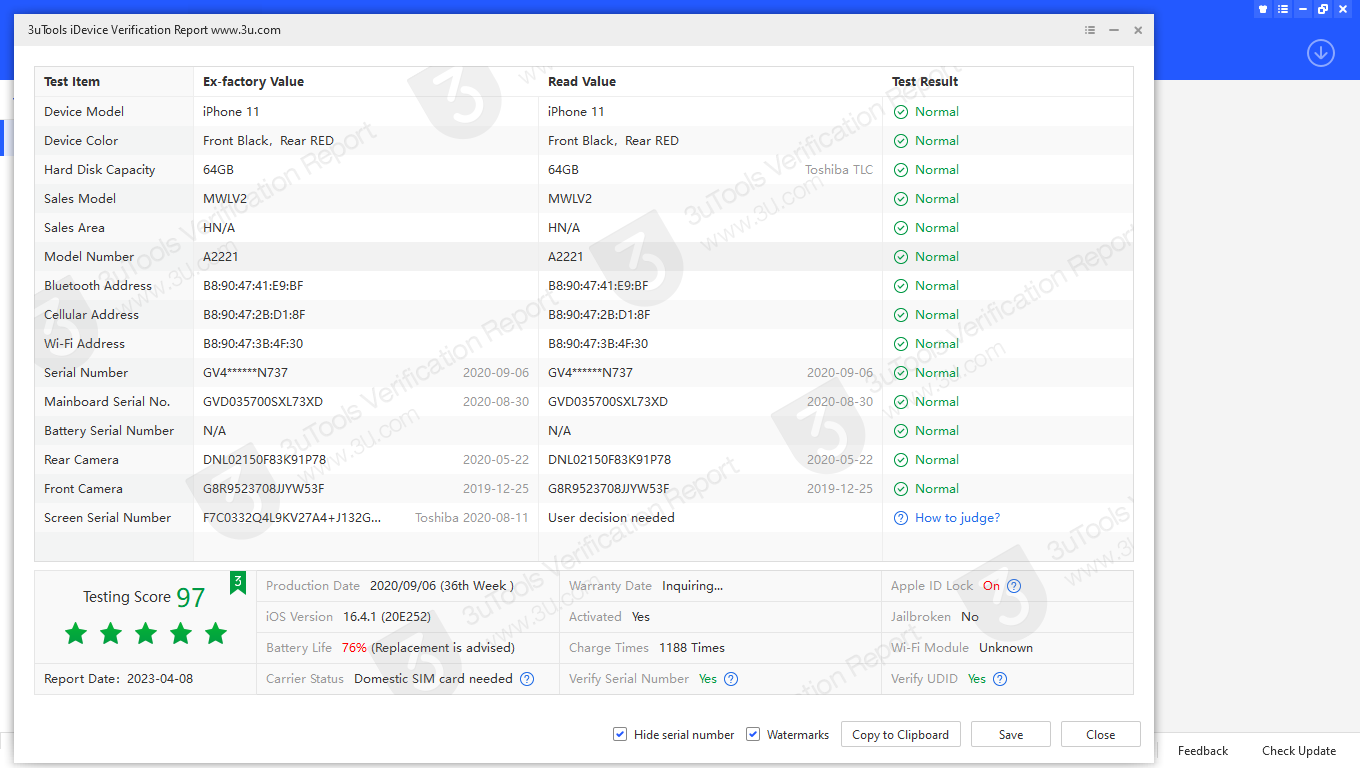

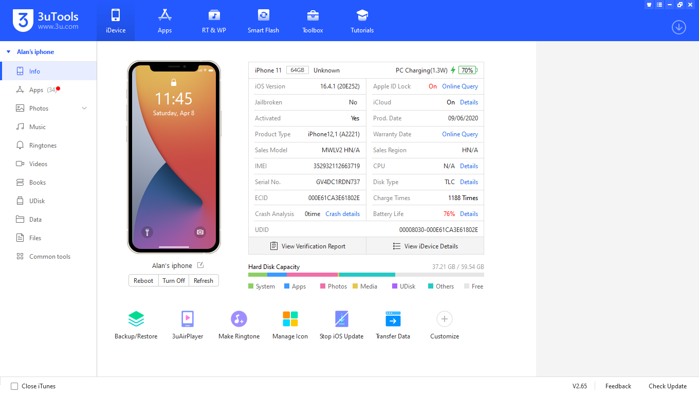

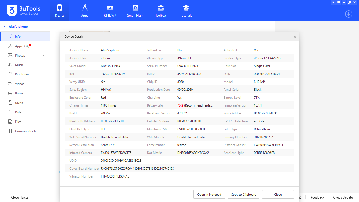

Sir na ipick service center ku iPhone11 battery replacement ku poiirundhen na original battery podasenen avangalum original potu irukam nu soonaga settings la battery percentage 100 nu display aguthu but 3u tools la battery percentage 74 nu display aguthu
Enaku original battery podangal illa deplicate ta nu theriyala konja pathu solringa la
Hi bro, reason I suggest apple service center to consider battery replacement is to avoid this confusion. :frowning: Third party service centers can replace original battery from other devices. Many users using it without issues recent days. Still, namma video la solliruntha mathiri battery mattum apple service center eppothume consider pannurathu better bro.
Already change panniteenga so dont worry. unga one day usage ku backup irukanu paarunga. battery health reduce gradual la irukum in coming months. entha issue naalum same iPick Service center neenga visit pannanumnga.
3utools la vara data again 2 to 3 months kalichu check pannunga or ethavathu issues iruntha paakalaamnga.
