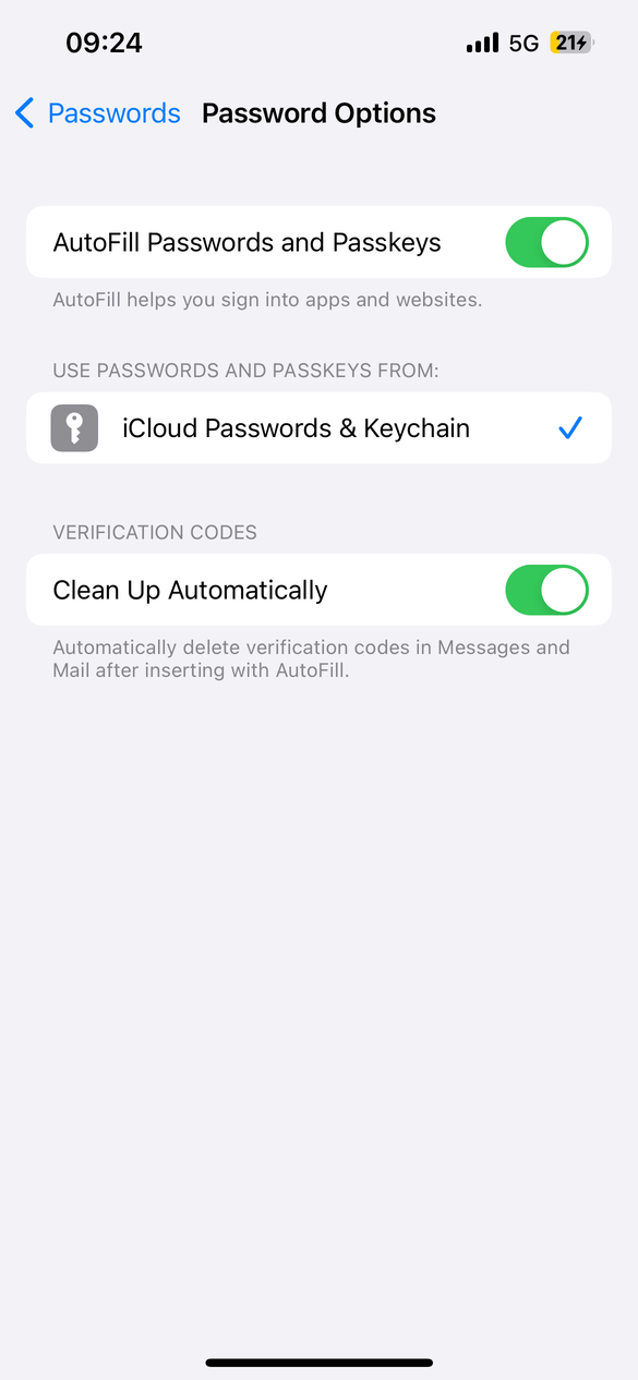

Hi bro, I was not using the auto delete OTP feature till date. Going to enable to see whether same issue happens or not. Need at least two days time to test it. meanwhile can you share Password Options screenshot here? Just to have a look at the setting.
Its correctly configured. I received an OTP and used autofill to enter. And I can see the OTP message auto deleted from the messages app. its working fine at my device bro. So I think issue you are experiencing could be temporary. Do perform “settings - general - reset - reset all settings” once.
