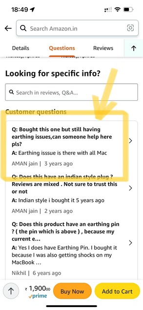

Try use this bro
Or any third party plug

Even i had this issue. I recently bought a Mac 14" M1 Pro laptop and faced this earthing issue. I generally connect the power brick to a Belkin surge protector but still i got the earth issue. So only changing the power brick with earth pin would help i guess. My thought is buying the universal adapter which is original apple product. We have a 3 pin plug in it which is compatible with any surge protectors. Please share your opinion in this ?
hello sakthi bro, as discussed above, the default adapter that comes with the box doesnt have earth pin. so yes, considering any branded 3 pin type adapter will be good idea. till now it didnt cause any problem even when people used it while charging. But its good idea as safety reasons, for us to consider using such 3 pin adapters bro.
